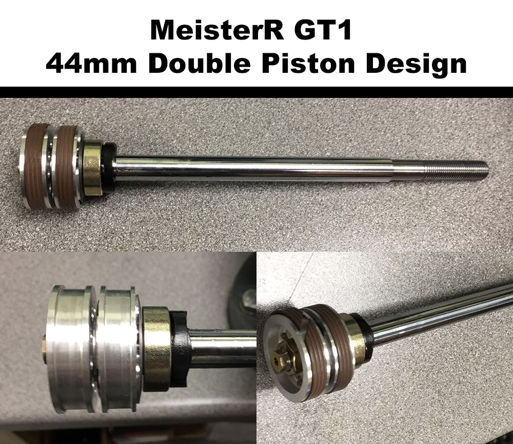

The GT1 coilovers is MeisterR top range 1-way adjustable coilovers for fast road & track use.
They are engineered by our in house technical partner Black Art Design located in Rayne, Essex, UK.
The GT1 uses CNC made internal that were engineered from the ground up in UK.
All internal components are CNC made in house at our UK workshop, none of the internal are out sourced.
All GT1 are assembled either at our UK or USA workshop depending on stock and location, but all internals parts are made in UK.
Here is a quick picture of what the GT1 44mm double piston assembly looks like:
In terms of performance, the GT1 are an 1-way compression and rebound combined adjustable mono-tube dampers.
The closest type of suspension to the GT1 will be the Ohlins DFV as both retain the "dual perch" design where the springs are adjusted independent of the ride height adjustment.
Other suspension that are in similar mono-tube categories that use more advanced CNC internal are the likes of AST, Nitron, Quantum, JRZ, etc.
Mono-tube damper are a lot more consistent as all parts that control damping force generation are located at the valve.
What this mean is generally you have much more consistent build result as if the piston, shims, and gas pressure are the same, you get very repeatable result.
It also provide faster damping response from high pressure charged gas (no phase delay), more consistent damping force under hard usage (no heat fade), and generally better damping characteristic from the larger internal piston.
KW is a Twin-tube damper, so they aren't really in the same performance damper category as a Mono-tube dampers
I am not sure about Eibach, they could be either. The only main stream brand that use mono-tube dampers are Bilstein.
That is a bit about the GT1, any other more specific questions, please feel free to let me know.
Is this comparison, on monotube being more "consistent", versus twin tube such as KW - last statement meaning these dumpers are superior to all variants of KW, including KW V3?
