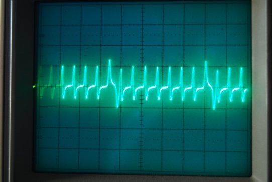

Risbo Posted October 13, 2009 Share Posted October 13, 2009 Za hallov senzor ne treba biti rotor sa magnetima - sto posto isprobano. I hallov je puno pouzdaniji od magnetnog uz "čitljiviji" signal (pravokutni) naspram sinusoide kod magnetnog. Link to comment Share on other sites More sharing options...
fire Posted October 13, 2009 Share Posted October 13, 2009 Za hallov senzor ne treba biti rotor sa magnetima - sto posto isprobano.I hallov je puno pouzdaniji od magnetnog uz "čitljiviji" signal (pravokutni) naspram sinusoide kod magnetnog. nije sinus kod vr senzora. Link to comment Share on other sites More sharing options...
Risbo Posted October 14, 2009 Share Posted October 14, 2009 jbga, je, mjerio osciloskopom Link to comment Share on other sites More sharing options...
fire Posted October 14, 2009 Share Posted October 14, 2009 jbga, je, mjerio osciloskopom Mozda imas los osciloskop, mozda gledao posle nekog filtera, a mozda ti je remenica bez ostrih rubova(ima glake rubove). To je bas fora vr senzora, dok dode blizu zub da napravi jaki i kratki signal. Link to comment Share on other sites More sharing options...
Risbo Posted October 21, 2009 Share Posted October 21, 2009 a kaj je ovo nego sinusoida Samo ima strme bregove.... Link to comment Share on other sites More sharing options...
fire Posted October 21, 2009 Share Posted October 21, 2009 a kaj je ovo nego sinusoida Samo ima strme bregove.... cista sinosuida koja se sastoji od zbroj beskonacno sisnusa Link to comment Share on other sites More sharing options...
mr_G Posted October 21, 2009 Share Posted October 21, 2009 Upravo. Kakva sinusoida... :lol: S tim da je napon impulsa ovisan o brzini vrtnje, tako da moraš imati filter za to... Dakle, puno bolji hall... Link to comment Share on other sites More sharing options...
