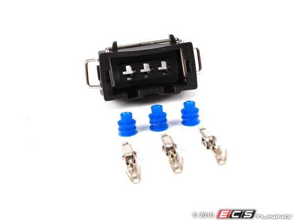

MOTA BOY Posted November 4, 2012 Author Share Posted November 4, 2012 (edited) Dobro, hvala na informacijama, al molio bih ak se nekom da iskopat ta 3 pina TPS-a? Hvala! EDIT: E da, ljeva je cca 63mm promjer, a desna cca 80mm. Edited November 4, 2012 by MOTA BOY Link to comment Share on other sites More sharing options...
fire Posted November 4, 2012 Share Posted November 4, 2012 1. masa 2. izlaz 3. napajanje Link to comment Share on other sites More sharing options...
MOTA BOY Posted November 5, 2012 Author Share Posted November 5, 2012 Esad, kak znat koji je prvi pin? Konektor je isti ovakav: Link to comment Share on other sites More sharing options...
fire Posted November 5, 2012 Share Posted November 5, 2012 Ako spajas na vems svejedno je koji je prvi pin. Na tps-u mozes napajanje i masu zamijeniti. Link to comment Share on other sites More sharing options...
MOTA BOY Posted November 5, 2012 Author Share Posted November 5, 2012 Hvala ljudino! Link to comment Share on other sites More sharing options...
