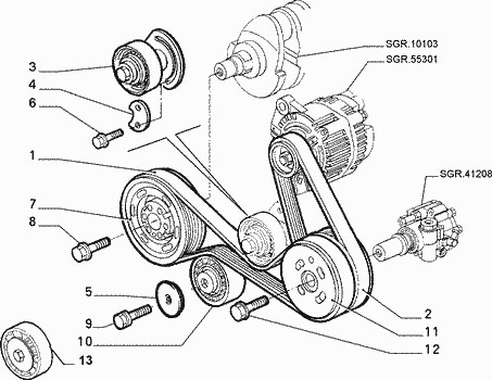

Jopa Posted August 24, 2013 Report Share Posted August 24, 2013 skinuo bi klimu s auta, i kad bi to napravio alternator bi mi se vrtio u kontra smjeru nego sada. Dali se to moze tako ili ipak trebam trazit alternator iz modela bez klime? hvala Link to comment Share on other sites More sharing options...
BMW_Motorsport Posted August 25, 2013 Report Share Posted August 25, 2013 mozda ubacit neku rolicu i kraci remen piknut Link to comment Share on other sites More sharing options...
Jopa Posted August 25, 2013 Author Report Share Posted August 25, 2013 kraci remen mi treba svakako a ubacivanjem rolica nisam nista dobio jer ih moram dvije ubacit a onda nisam nista ustedio na mjestu i na kraju sam se vise izje nego da sam kupio sve potrebno i prebacio gore znaci ovako je u originalu, odozgora prema dolje idu kompresor klime, alternator i servo pumpa. i kad bi maknuo kompresor klime to bi ovako izgledalo i alternator se vrti kontra brine me da mi nebi alternator poslao + na masu ako se kontra vrti? Link to comment Share on other sites More sharing options...

ZOD Posted August 25, 2013 Report Share Posted August 25, 2013 An alternator generates AC current, doesn't matter which way it turns. The output is rectified to give you 12 VDC, ground will remain negative. So you would think it would be ok to reverse rotation. HOWEVER, the alternator has a fan, which is either located behind the pulley or internally. Most internal fans are omnidirectional, so rotation direction won't matter. Most external fans are either clockwise or counter clockwise. Zavrti ga vani na stolu nekom i gledaj kako se ventilator ponaša, obično izvlači vrući zrak iz alternatora. Link to comment Share on other sites More sharing options...

Jopa Posted August 25, 2013 Author Report Share Posted August 25, 2013 Nije ti lakše nabaviti nosač drugi? mislim da imam ja jednog viška Nosac mi treba svakako, daj molim te pogledaj dali imas 2 Zod i Alfa- sutra cu bas pogledat te cetkice i vidit situaciju s ventilatorom, makar po ovom tekstu je u mom slucaju svejedno jer je ventilator unutar kucista Hvala! Link to comment Share on other sites More sharing options...
