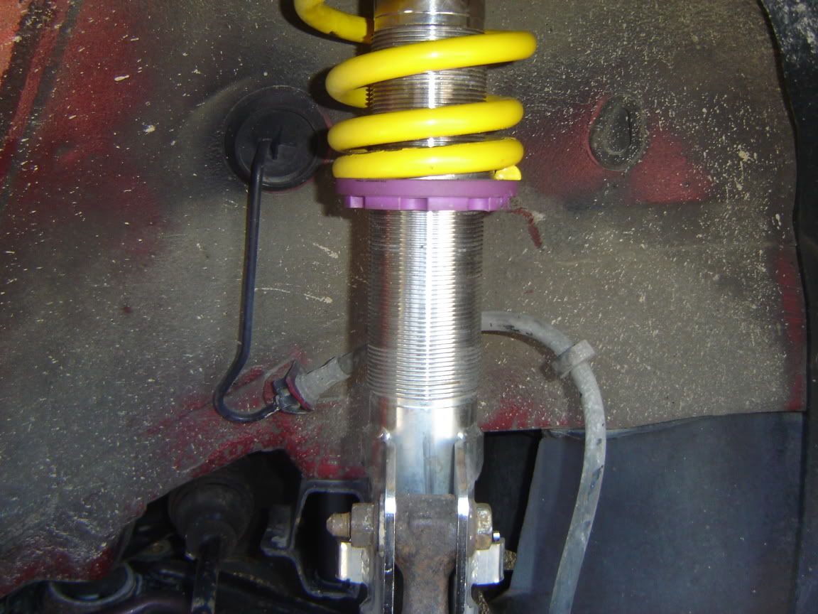

jura_vw Posted March 8, 2010 Share Posted March 8, 2010 kod men su 3 godine, a kod frenda od kojeg sam ih kupio isto 2 ili 3 godine, ne znam točno... i evo stanje... Link to comment Share on other sites More sharing options...

charger Posted March 8, 2010 Share Posted March 8, 2010 KW nije kinesko smeće, naravno da je ko novo Link to comment Share on other sites More sharing options...
