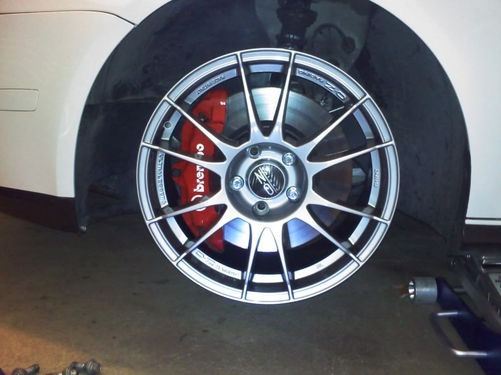

Petar001 Posted December 14, 2014 Report Share Posted December 14, 2014 (edited) 330 disk i 6 klip brembo ti je max sta stane u 17 I to super/ultraleggera sa et 43 Evo slika Edited December 14, 2014 by Petar001 Link to comment Share on other sites More sharing options...
SVEN Posted December 14, 2014 Report Share Posted December 14, 2014 zaboravljate bitnu stavku a to je dizajn krakova iznutra . Mogu biti ravni ili zaobljeni sto je nepovoljno po celjusti za koje u tom slucaju zapinju . Link to comment Share on other sites More sharing options...
Rallye VR6 Posted December 15, 2014 Report Share Posted December 15, 2014 Ultre i super definitivni imaju najpovoljnije krakove. Link to comment Share on other sites More sharing options...
