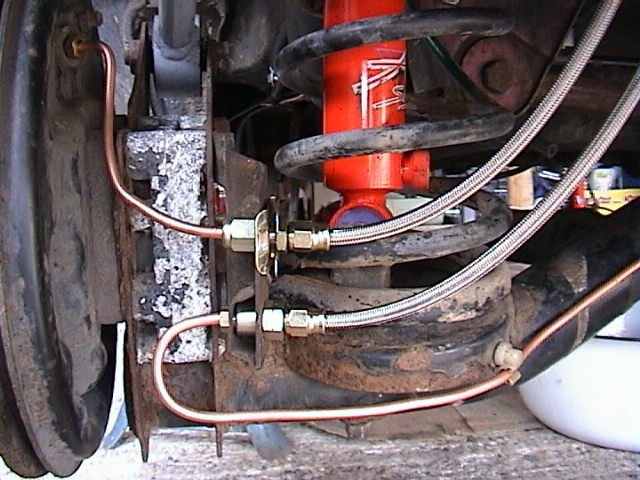

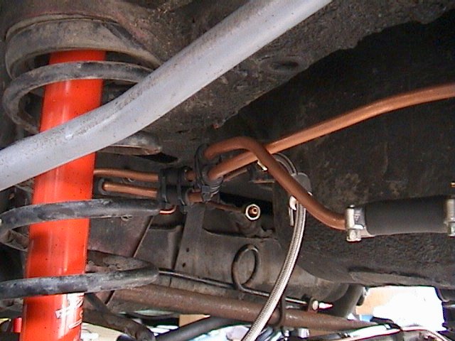

Boxer Posted September 4, 2009 Share Posted September 4, 2009 Dakle trebam navedene i za kočnice i za gorivo..... Gdje ih ima u metraži i pošto??? Link to comment Share on other sites More sharing options...
bvlahov Posted September 4, 2009 Share Posted September 4, 2009 VEP hidraulika u Vrapču ti napravi kakve želiš. Vrapcanska 8, Zagreb 01/3457293 Link to comment Share on other sites More sharing options...
Boxer Posted September 4, 2009 Author Share Posted September 4, 2009 Super, hvala na info-u....Meni treba metražno jer si budem sam slagao to gore kad dođe vrijeme:naughty: Link to comment Share on other sites More sharing options...
killuminati Posted September 4, 2009 Share Posted September 4, 2009 možda sam u krivu, ali mislim da nisu opleteni barkom, več čelikom.. Link to comment Share on other sites More sharing options...
Boxer Posted September 4, 2009 Author Share Posted September 4, 2009 Neću opletene, trebaju mi obične lajtunge samo ne metalne nego bakrene... Link to comment Share on other sites More sharing options...
rio_cyber Posted September 4, 2009 Share Posted September 4, 2009 ja kupiuo po 3 kune metar ili tako nest fi 4 mm u ducanu za vodovodne djelove ))), iskrostio stare fitinge i frend mi zapertlo sa ogrinal masinom, u vep-u cini mi se da metar cjepaju 19 kuna ili tako enes ili mozda 9 . ? ? Link to comment Share on other sites More sharing options...
Boxer Posted September 4, 2009 Author Share Posted September 4, 2009 Onda super, idem sutra pogledat tu kod mene po dućanima za vodovod:thumbsup: Ja imam mašinicu doma za pertlanje a fitinge naravno stavim stare....Također budem bakar stavljao za dovod i povrat goriva pa mi i za to treba 8 odnosno 6 mm Link to comment Share on other sites More sharing options...
rio_cyber Posted September 4, 2009 Share Posted September 4, 2009 i to sam stavio..... isto da,sve lajtunge sam zamijenio .... makar vele da se ne bi smjeli stavljati vise bakreni lajtunzi kao zbog ekologije sta vec,, ne obazirem se na to, Link to comment Share on other sites More sharing options...
