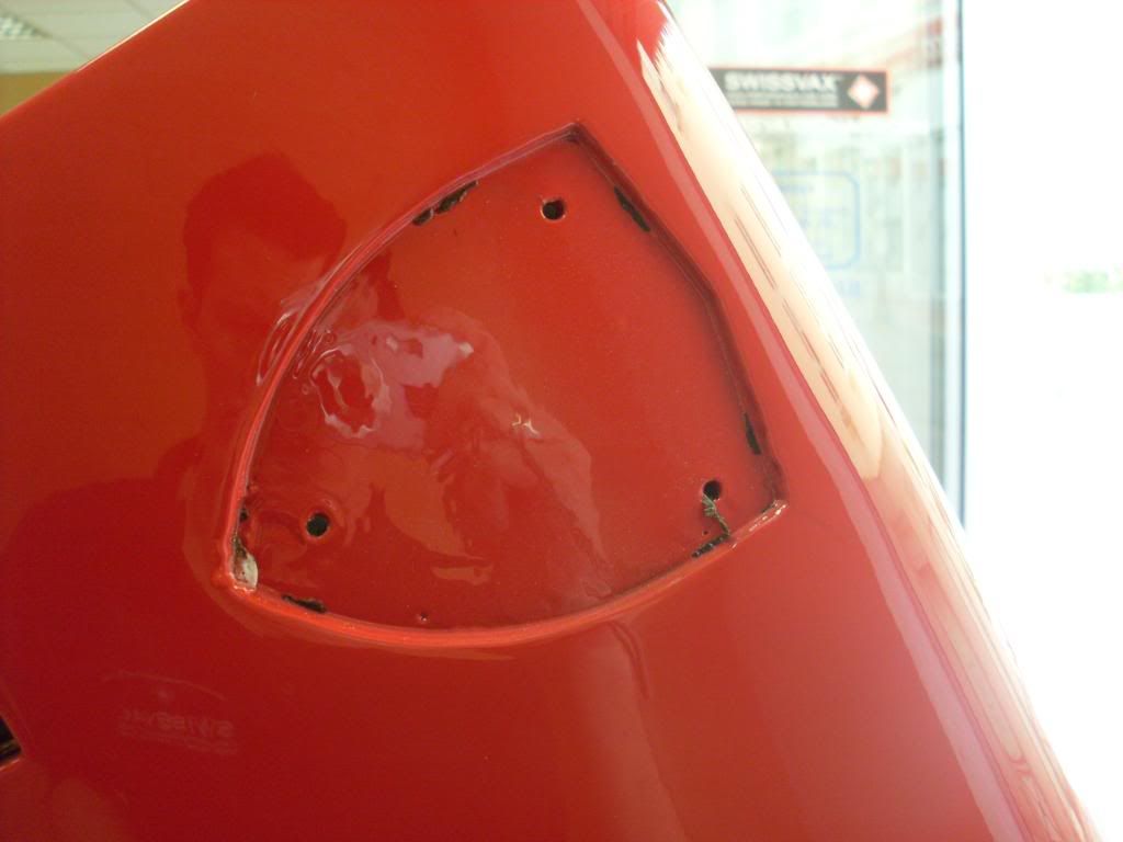

After an extensive wash which took nearly 2.5 hours, I started to strip the main bits that could be stripped off the car like badges, air vents etc

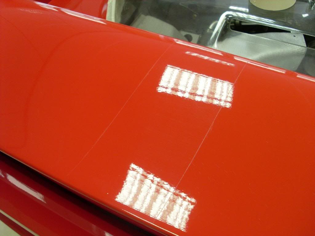

I then inspected the body work, masked up ready for machining.
Products used were
Swissvax Quick Finish
Swissvax Paint rubber (blue)
Swissvax cleaner flud strong, medium & professional
Car was then clayed

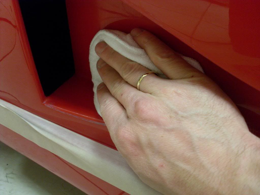

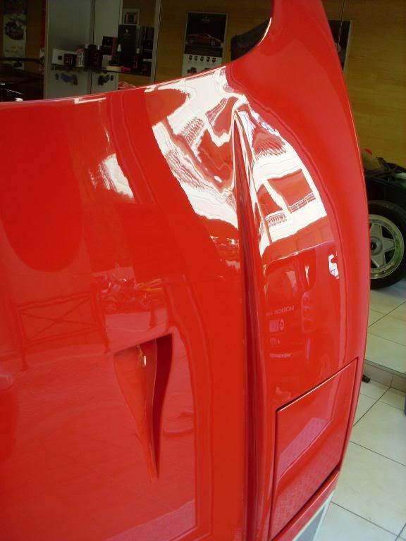

followed bay a good old machine polish with the strong & lambswool head @ 2000rpm, i choose the lambswool because of its abilty to remove scratches quick, a keen eye is a must and it is important to keep the surface moist, to do this i use QF and give a quick spray on the machine head every now a then. Following the strong came another machine over with the medium @ 1500rpm on a med cut pad to remove some of the fine swirls that the lambswool head had put in, it was then done again with the professional @ 1000rpm with a fine finish pad.
Hard to reach bits were done by hand

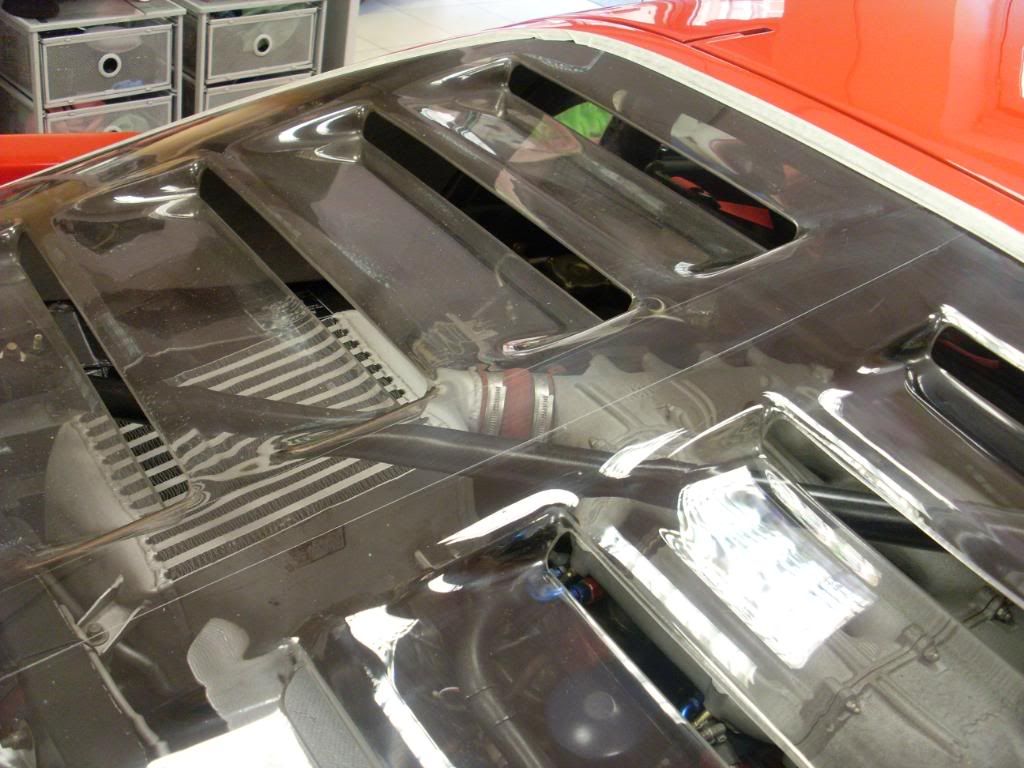

Then came the job of the rear perspex screen, how hard was this to do!
Out came the trusted cleaner fluids again!
so i set to work..........
Machining this was an art as to much heat would have burnt the perspex, i used very low revs for all the products, the underside of it was even harder with me having to sit on the engine with a cushion!
It was then given an application of SWISSVAX Shield on both sides.

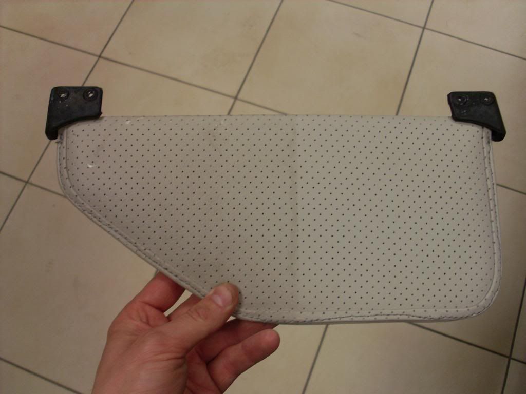

with the exterior done i then set to work stripping the interior, headlining out, seats out...

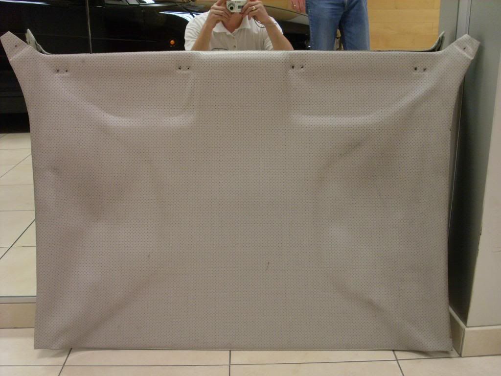

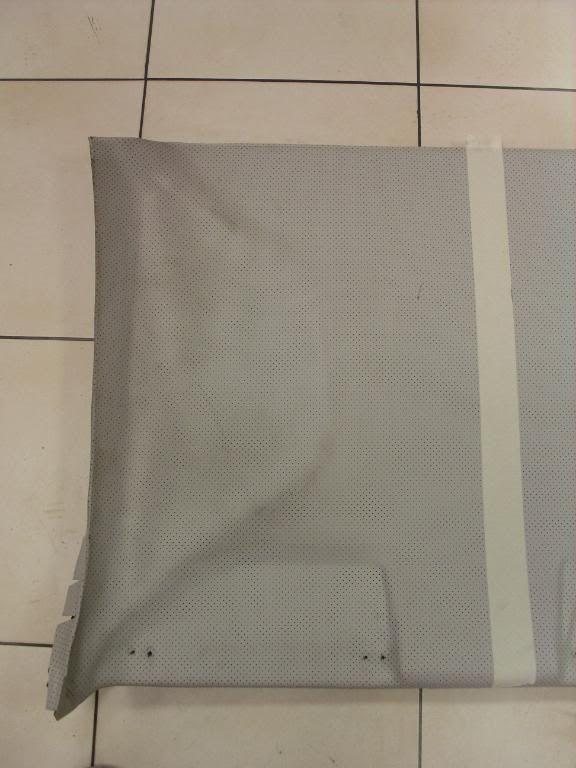

The headlinging had dropped above the seats which is a common fault with the F40, with a little post on a forum asking how to remove it etc out it came.
It was then cleaned with while the leather was still on.

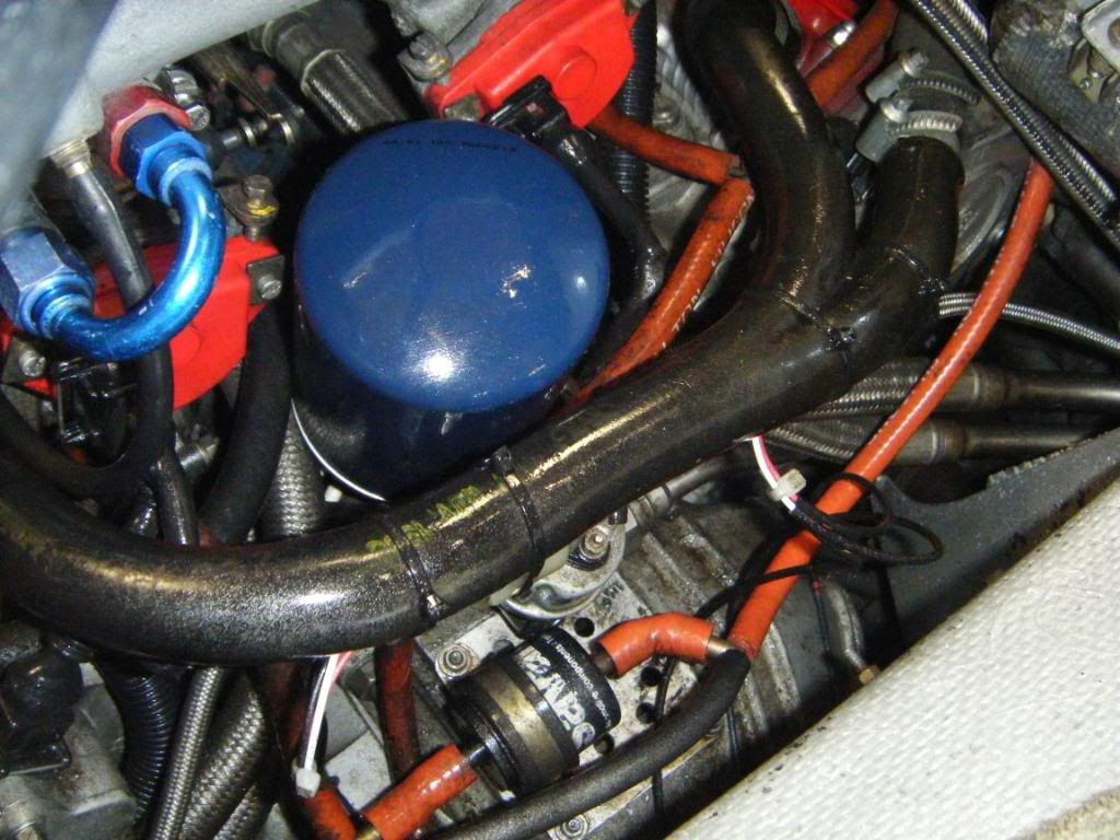

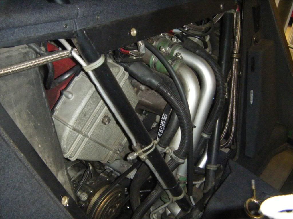

THE ENGINE
Now this was the hardest part of all as it all had to be done by hand! Some of the dirt was so ingrained it would not move even with a strong degreaser.
Then on to the front section all cleaned by hand! The battery cover was removed & painted matte black.
Seats were cleaned and put back in as well as the headlining

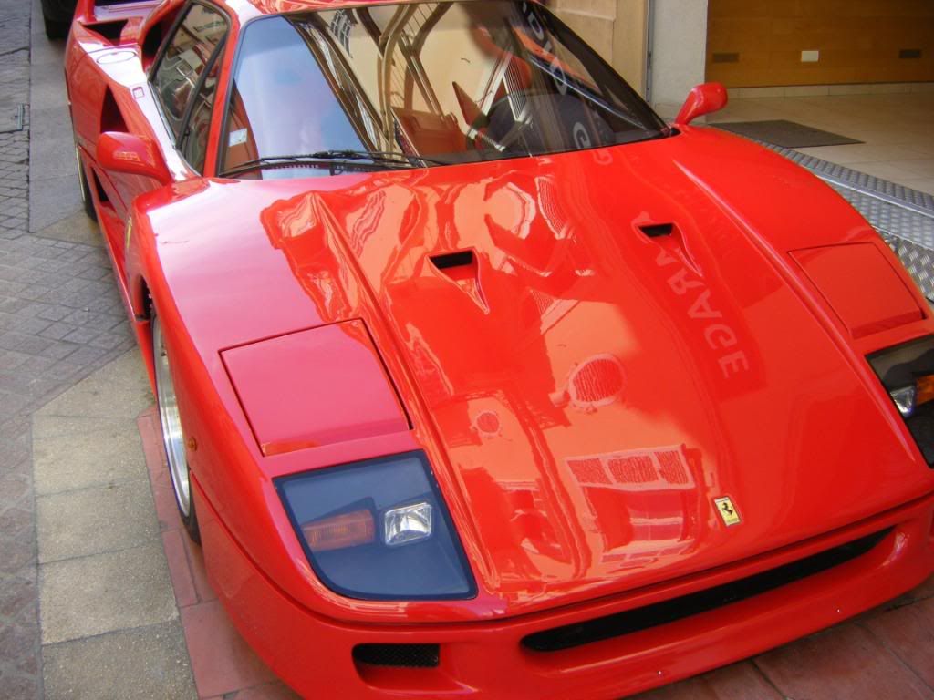

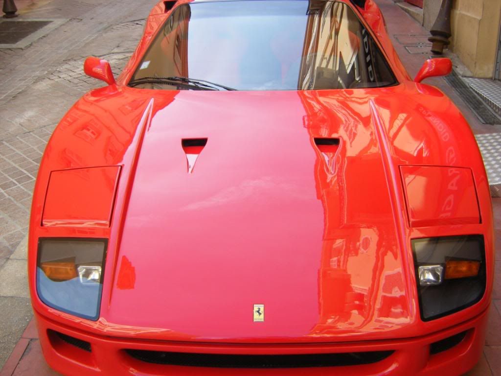

After that it was done, so a trip to the port with owners permisson to take some snaps, but not before i had done the F430!
A few outside the office.... Plate is our trade one not clients.
To the port
