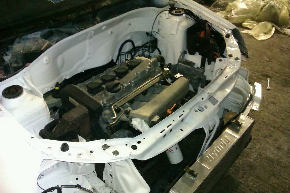

esseker Posted October 19, 2011 Share Posted October 19, 2011 da li je ovo 1.8T VAG iz cetvorke? koja je tocno oznaka? gdje su mu ostali nosaci motora, koja getriba ide na njega? moze shema motora i vise info? btw ovo nije Perin rad Link to comment Share on other sites More sharing options...
Kroky Posted October 19, 2011 Share Posted October 19, 2011 po izgledu bi reko da je. 1.8T 180ks iz leona i octavie rs je oznaka AUQ, ima ih jos, al ovaj sam imao pa sam zapamtio :lol: Link to comment Share on other sites More sharing options...
Mramor Posted October 19, 2011 Share Posted October 19, 2011 kod je zakucan na gornjoj strani glave pa pogledaj. bode u oči. Link to comment Share on other sites More sharing options...
Kroky Posted October 19, 2011 Share Posted October 19, 2011 tu je, samo nekak mi se cini da nemre doc do auta Link to comment Share on other sites More sharing options...
Mramor Posted October 19, 2011 Share Posted October 19, 2011 e... nek onda iskoristi photoshop i napredne filtere Link to comment Share on other sites More sharing options...
mrlakis Posted October 20, 2011 Share Posted October 20, 2011 čini mi se da je ovo usisna grana sa širim kanalima,portovima,a možda se i varam Link to comment Share on other sites More sharing options...
esseker Posted October 20, 2011 Author Share Posted October 20, 2011 da, auto je u UK ovo je Clio btw :naughty: Link to comment Share on other sites More sharing options...
mrlakis Posted October 20, 2011 Share Posted October 20, 2011 znači da je kod jedan od ona dva šta imaju široke portove,aeb i ? a nosač mu je onaj komad hrđavog željeza,druge nije moguće vidjeti. Link to comment Share on other sites More sharing options...
fire Posted October 20, 2011 Share Posted October 20, 2011 agu glava ima najsirije kanale. Link to comment Share on other sites More sharing options...
francuz Posted October 20, 2011 Share Posted October 20, 2011 AGU je najbolji za tuning, ako sam dobro upućen Link to comment Share on other sites More sharing options...
Vila Posted October 20, 2011 Share Posted October 20, 2011 je AGU stavljaju svi tjuneri 1.8T-a Link to comment Share on other sites More sharing options...
tcode Posted October 20, 2011 Share Posted October 20, 2011 Ja sam upućen da ste vi dobro upućeni. Link to comment Share on other sites More sharing options...
ZOD Posted October 20, 2011 Share Posted October 20, 2011 Link na projekt? Glede nosača, nije ti ni toliko bitno di su serijski jel se da svašta napravit ovisno o autu u koji ide. Link to comment Share on other sites More sharing options...
Ivo GTi 16v Posted October 20, 2011 Share Posted October 20, 2011 AGU je najbolji za tuning, ako sam dobro upućen i AEB ima isto siroke kanale :thumbsup: Link to comment Share on other sites More sharing options...
KIMI_1.8T Posted October 20, 2011 Share Posted October 20, 2011 Ja sam upućen da ste vi dobro upućeni. Nisu.:no2: Jedan je cuo, a svi ponavljaju. A, sto je najbolje,..... samo su djelomicno u pravu. Link to comment Share on other sites More sharing options...
Rallye VR6 Posted October 20, 2011 Share Posted October 20, 2011 (edited) Ima i stare bobine , iako to ne znači ništa , mogao bi biti AGU. Vidi se da je noviji blok , znači nije AEB iz passata ili A4. Davno je bio neki clio 1.2 sa 1.8T Edited October 20, 2011 by Rallye VR6 Link to comment Share on other sites More sharing options...

esseker Posted October 21, 2011 Author Share Posted October 21, 2011 zanima me zbog nosaca - moj je na istom mjestu skoro. iz A3 je, GT2860RS turbo, projekt ovdje http://cleaned-uk.forummotion.com/t2573p480-iporn-grid-clio-fast-car-cover-car-18-oct-pg33-engine-fitted-but-what-engine-d ZOD to ti je ovaj Link to comment Share on other sites More sharing options...

obie Posted October 29, 2011 Share Posted October 29, 2011 i AEB ima isto siroke kanale :thumbsup: istina. :thumbsup: i da, ovo gore je 1.8T 100% Link to comment Share on other sites More sharing options...
