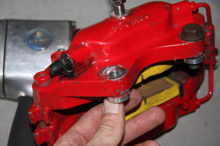

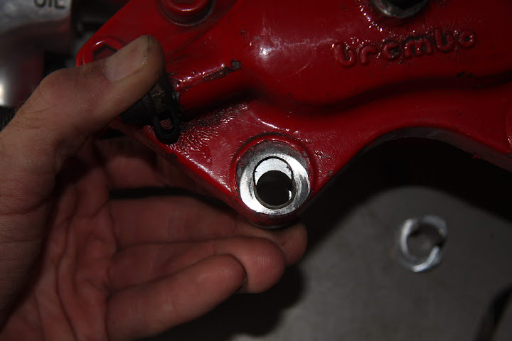

Rallye VR6 Posted January 16, 2014 Share Posted January 16, 2014 Mogu se čeljusti od Porša /RS2 preraditi i ovako da ostane 280mm disk Link to comment Share on other sites More sharing options...
