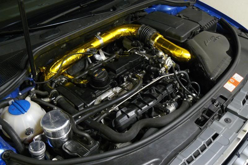

Raptor6767 Posted May 31, 2011 Share Posted May 31, 2011 Link na eBay I kako je to MarioS3 napravio: Link to comment Share on other sites More sharing options...

ZOD Posted May 31, 2011 Share Posted May 31, 2011 Ova zlatna mora donositi konje sigurno. Link to comment Share on other sites More sharing options...
tcode Posted May 31, 2011 Share Posted May 31, 2011 Ili barem zlatnu medalju. Link to comment Share on other sites More sharing options...
