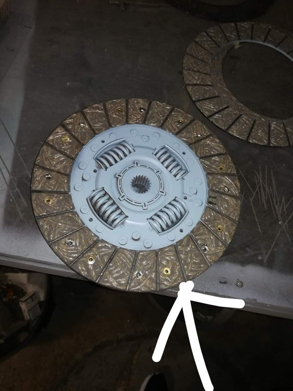

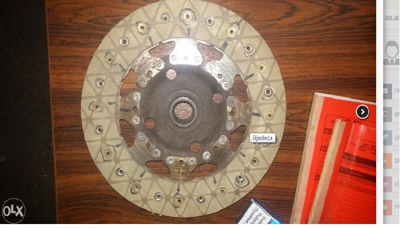

turbonetics Posted February 13, 2019 Author Posted February 13, 2019 Hvala svima na odgovorima, znam da sinter spali to sve,zato mi se i ne radi. Eh sad imam dvije opcije kevlar ili nesto izmedju evo slika. Kevlar ili ovo polukevlar
zivac Posted February 13, 2019 Posted February 13, 2019 Kevlar preskoci, ja sam ga sa neki 420nm ubio u 1000 km Sachs performance korpa/lamel deklarirano drzi 580nm, proklizavao na 520nm
dejanR Posted February 13, 2019 Posted February 13, 2019 Ja sam na integralki imao OMP car performance kit (korpu i lamelu)... Drži izvrsno...
turbonetics Posted February 13, 2019 Author Posted February 13, 2019 A nista probat cu ovaj g95 materijal,pa sta bude bude
