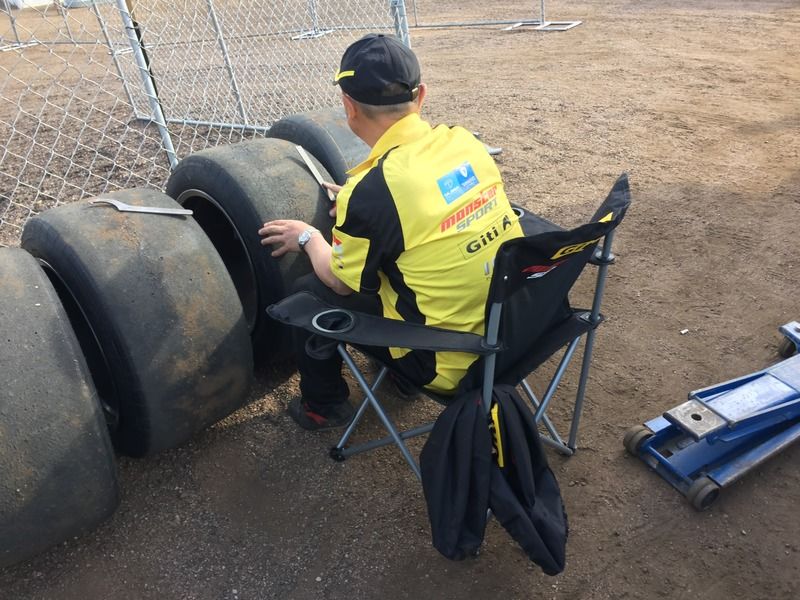

CroDriver Posted April 29, 2016 Posted April 29, 2016 Uros said: Koje to gume prenesu 1600 Nm po kotacu na cestu ? Ove, kad su tople
